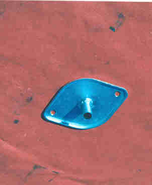

i have a edelbrock victor efi manifold part number 29365 for my 445 stroker, it has a hole at the rear of the manifold i guess it was used for a oil fill or breather?. the manifold comes with a block off plate could i drill out the plate and put a gromet and run my pcv valve off of it?. i have the ford motorsport cobra lemans valve covers and planned on running the twist in chrome caps with breathers. will this work or would i have any problems.

You mean, something like this?

i have just the plate with out the tube, i have a 4 barrell style throttle body i thought it would be nice to hide the pcv valve there instead of putting it in the right side valve cover, then i could run the hose from the back of the t body down to the plate.
