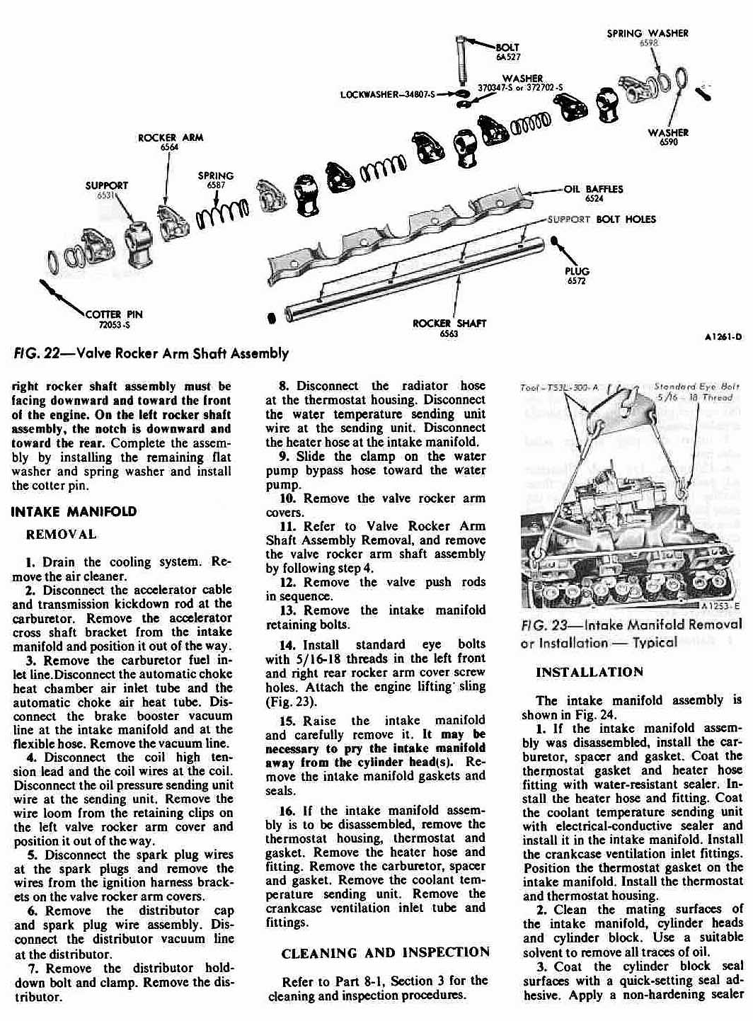

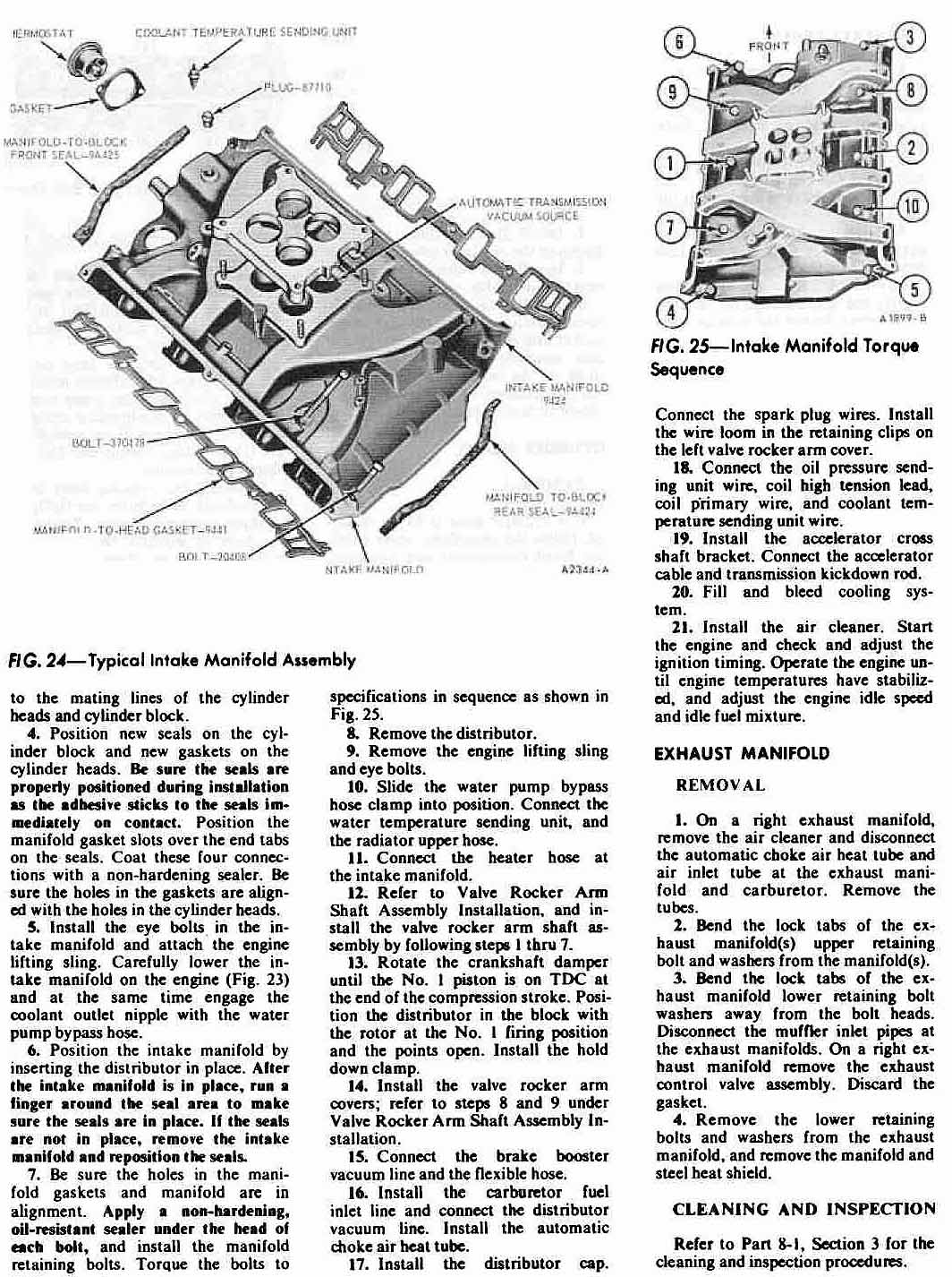

ZOERA-SC7XX -- if you want me to post the Ford 428 service manual pages on pulling the intake manifold I will. It's pretty intuitive; the hardest part is lifting it off once you have everything unbolted (and that's with aluminum, with iron you've got to use a lift unless you're Barry R., whom I'm told can get dead lift an iron manifold while bending over like an inverted 'L' ):JEKYLHYDE.
patrickt 07-24-2009 11:42 AM
Here it is...
I received a request to post these whether ZOERA-SC7XX wants them or not :LOL: so here they are:
http://www.clubcobra.com/photopost/d...anifold011.jpg
http://www.clubcobra.com/photopost/d...manifold01.jpg
http://www.clubcobra.com/photopost/d...manifold02.jpg

Heads are old rebuilt and appeared to have top shelf workmanship. I have no problem assembling/disassembling the intake, heads, whatever needs to be done. My only question after seeing your schematic is the rocker assemblies. I rebuilt them using spacers and shims from DSC Motorsports, but I did not notice a difference between right side and left. The oil holes in the shafts are lined up properly with the rocker arms. The fit and function are fine. What it this 'notch' they mention?
patrickt 07-24-2009 04:45 PM
That is the ever-important "Identification Notch." Note that I have edited my previous post to include the preceding page of the manual that talks about it in an extra bold font to emphasize how important the Ford engineers deemed it to be.;)
