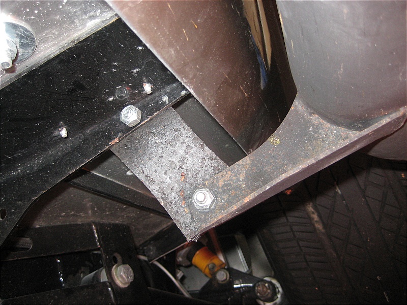

Jamo 08-24-2010 12:54 AM
So I go and take pics, and then realize I haven't loaded Photoshop into my new laptop yet. I'll try to get that done tomorrow. Otherwise, you can eyeball it at SAAC.
It's a two-piece affair...one long arm welded to the pipe, and another long arm welded to main frame tube...joined together with a good sized bolt. Allows for fine adjustment of the pipe height and the long length probably provides a certain amount of flex without it being rubbery.
