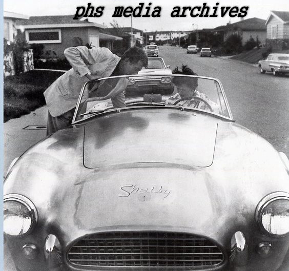

Well, CSX2000, the very first Cobra, was steel wool aluminum, a little less labor intensive. Of course, it was that color for a very short time! Chers, Dennishttp://www.clubcobra.com/forums/pict...ictureid=19882 http://www.clubcobra.com/forums/pict...ictureid=19879
