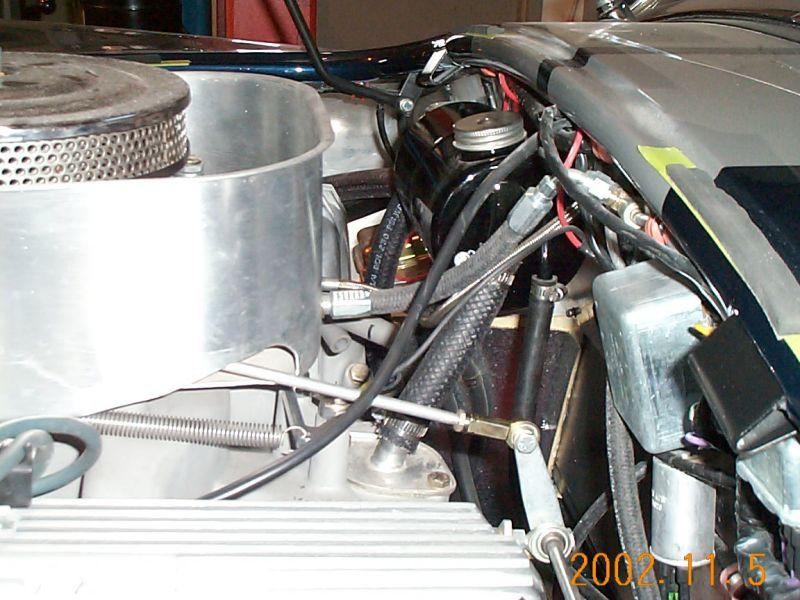

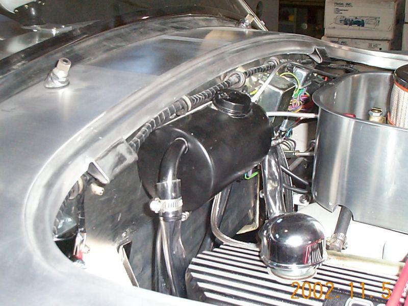

The oil puke tank mounts on the firewall on the right side of the car. The breather tube lines up with the intake manifold breather. It is hard to explain, but I will get a photo posted for you.
David :):):)
computerworks 07-23-2007 06:58 AM
Had these older pics handy...
http://www.clubcobra.com/photopost/d...uketank-02.jpg
http://www.clubcobra.com/photopost/d...uketank-03.jpg
http://www.clubcobra.com/photopost/d...uketank-01.jpg
Here you can see the three horizontal holes for mounting, on the far left...
http://www.clubcobra.com/photopost/d...ketank-04a.JPG
