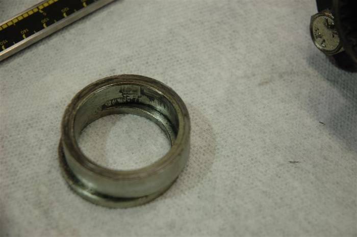

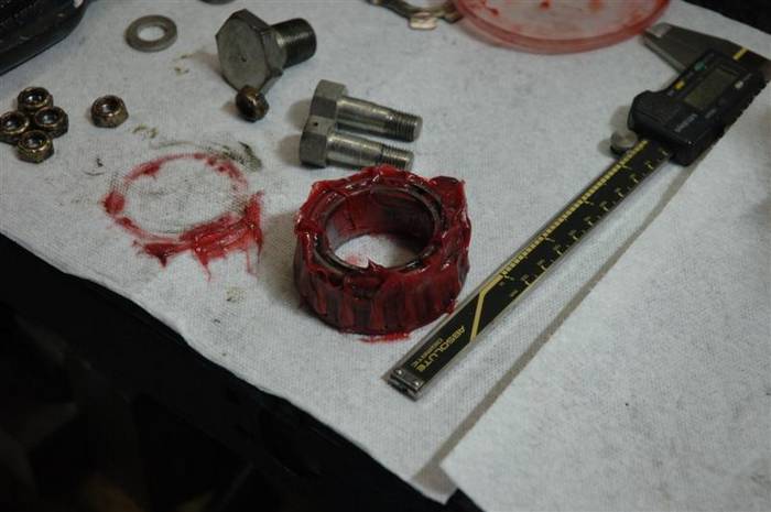

Now for a discussion of the Achilles Heel of the 289 and the 427 Cobra. The bearing spacers. Space does not permit me (or the rules of this forum :) ) to accurately describe my feelings toward these spacers. Suffice it to say they are an abomination (right next to the McLeod hydraulic throw out bearing).
The original Cobra (including 289 FIA, 427 Comp, 427 S/C, and 427 Street) used tapered roller bearings in the rear upright. (Just for interest's sake, the 289 street car used 2 standard roller bearings). Tapered roller bearings have to have a certain amount of preload on them to run right. If the bearings are too loose, then your rear hub will be loose and wander all over the place. (Not good unless you like saying your Hail Mary's at the end of the strait). If your bearings are too tight, they will burn up in short order, probably seizing the rear bearing and then spinning it on your rear hub. (Not good unless you like calling Kirkhams on the phone and begging them to custom make you some extremely expensive rear hubs.) There is an extremely fine line between too tight and too loose. It is only about 0.001 inches. You want the hubs to have about 25 inch pounds of resistance on them when you turn the hub and have it all preloaded correctly. The preload is set by the length of that stupid shim. When everything is right--it makes a marginally acceptable solution to the problem of rear hub bearings. Today we have MUCH better solutions--like double row angular contact bearings that come on a Porsche. But that is a story for another day.
In our experience, the rear upright bearing shims are seldom--if ever--set up correctly. Because the shim must take up the preload of the bearings, it is itself a bearing of sorts. As such, it MUST be made out of HARDENED STEEL!!! Everyone makes them out of mild steel and then prays to the bearing shim gods that they will hold up. They will not. They will FAIL after as little as 10-100 miles. Expecting them to hold up is much the same as praying to the Turn 1 god in hopes you will make the turn after you missed your braking point. Let's face it, if you have resorted to praying you will make the turn, you are probably going to shortly experience 4WD in a Cobra. Not so bad a Miller Motorsports Park (probably just humiliating as you spin off in a cloud of dust the size of Hurricane Katrina) but quite probably DEADLY at most other tracks.
If you look closely at the inner portion of the surface of the shim you can see it is colored differently than the outer portion. That is because 0.010 inches has been WORN OFF THE SURFACE!!! :eek:
We make our shims out of hardened 4340! Absolutely bulletproof. Pun intended...
OK, let me explain the pun. 4340 is the mil spec used for armor. It is hell on tools (and Osama's buddies) but it is about the ONLY thing that will stand up the the beating.

As for have I ever seen them fail...well, look here in the pictures I am now posting. Notice the washer was already bent. It is very hard to see in the picture, but the bearing spacer is already grooved out 0.010 inches. It was grooved out by something. That 0.010 inches has to have gone somewhere. It did. I came right out of the preload of the bearings.
As a final note...have you ever seen a lock tab on an engine connecting rod? (OK, not on an old tractor, but on a modern car?) NO! They don't use them because they don't work. If anyone was interested in keeping a nut and bolt together it would be on a connecting rod bolt. They take a pounding, but there is no lock tab to be found anywhere. The preload of the bolt keeps the nut and bolt from coming apart. Leaving a soft material under the head of a bolt or nut is just begging for it to squish out; consequently, all of the preload in the system will be lost.

Yes, I have seen some of them fail. I have taken apart rear hub bolts with my fingers after they have been run hard and pounded out the shims, washers, and lock tabs. I have even seen some cars that were put together with thin 0.002 inch shims to get the preload right--that pounded out and literally broke apart under the loading. Very nasty little 0.002 inch pieces of shim were running in the bearings.
All of that material that was gouged off of the surface of the bearing shim I showed in the above pictures had to go somewhere. It went into the rear bearings. At best you could hope for a ruined bearing and the time and wits to catch it before something more expensive (or worse) happened. Look at any modern car that bolts the axle through the hub bearing. No one uses a locking tab under the nut any more. (They all use lock nuts, however.)

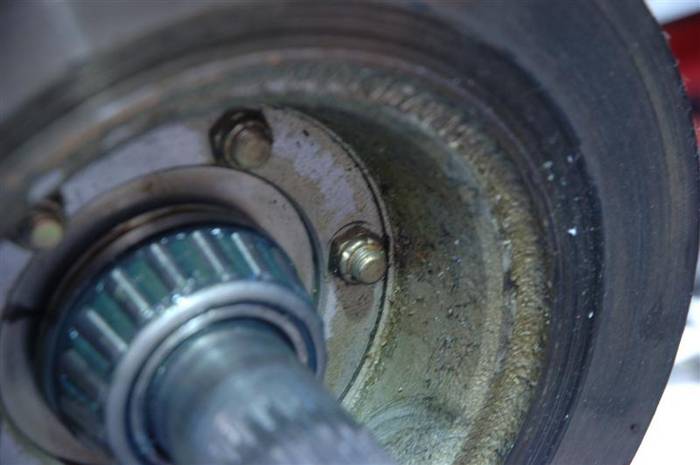

David Kirkham 09-03-2007 03:34 PM
Here you can see another common problem in original Cobras. Here you see whoever put this together used nylocks. The brake rotor can get well past 1000 F degrees under hard braking. The nylon in the nuts will break down in short order riding next to such temperatures. We strictly use all metal aircraft lock nuts here. Original cars used all metal lock nuts here as well.

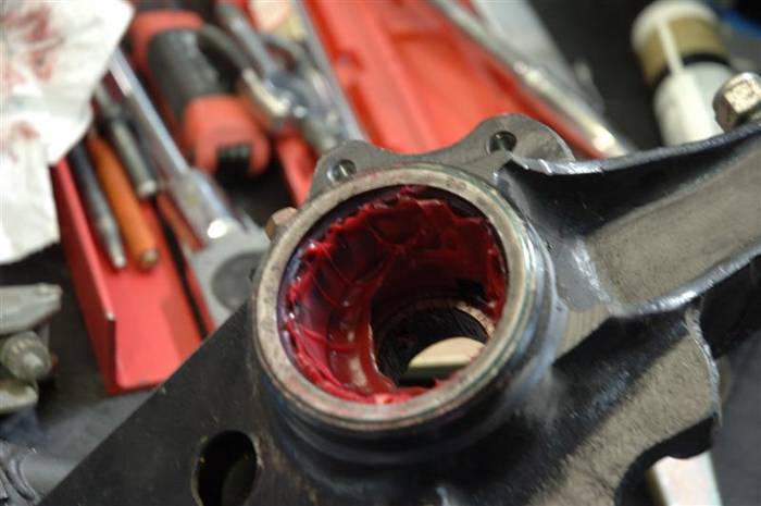

David Kirkham 09-03-2007 03:45 PM
Then he puts it back in the upright. We use Mobil 1 synthetic grease. It has very high temperature characteristics. BUT don't get it on your clothes! It will NEVER come out.

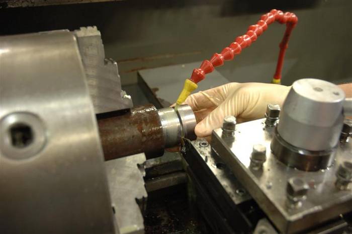

David Kirkham 09-03-2007 03:49 PM
Now it is time to address that dang bearing spacer.
Master Machinist Sandwich knows that the slop in the rear upright was about 0.004 inches. He just knows from experience. So he goes off to the lathe and whips out a spacer out of Godzilla, pre-heat treated 4340. This takes some time. Notice he makes the entire shim in one operation and then cuts it off. You have to be SURE your ends are absolutely parallel.
http://www.clubcobra.com/photopost/d...03_Medium_.JPG

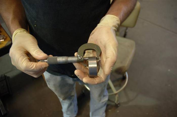

David Kirkham 09-03-2007 03:51 PM

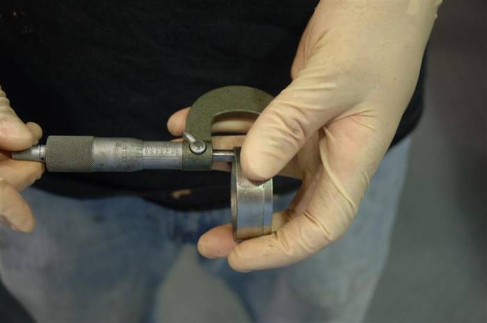

Sandwich got his measurement from running the mic on the original shim stack.
http://www.clubcobra.com/photopost/d...05_Medium_.JPG
David Kirkham 09-03-2007 03:52 PM
And then making the replacement shim exactly 0.004 inches shorter. Here he is checking his work to make sure there is 0.000 run out.
http://www.clubcobra.com/photopost/d...04_Medium_.JPG

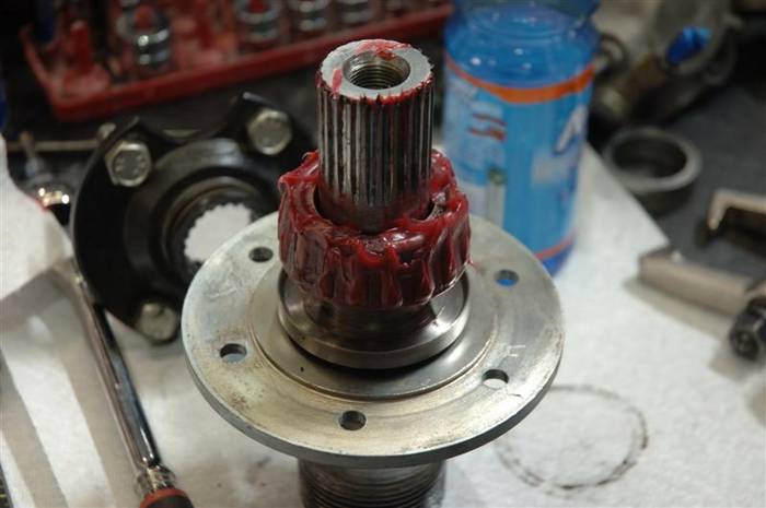

Clean, check, and grease the inner bearing.
http://www.clubcobra.com/photopost/d...07_Medium_.JPG

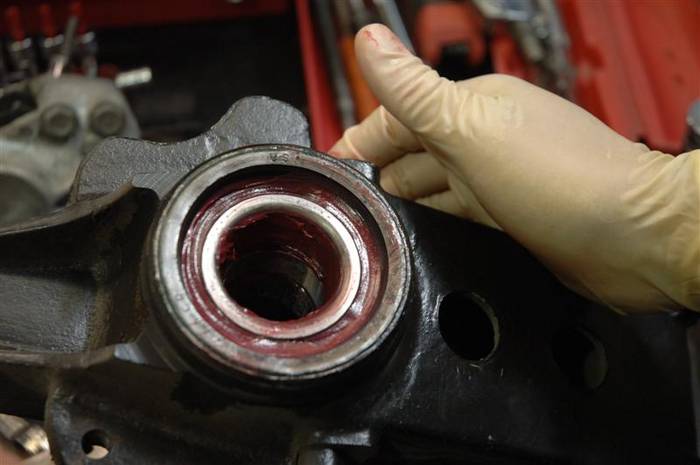

David Kirkham 09-03-2007 03:57 PM
Put some grease on the races. You don't want the bearings to run dry!!!! Don't burn up the outer bearing--last check, I was quoted $400/bearing from Timken! Oh man, original cars are expensive! I wonder who told Timken that bearing fit an original Cobra!

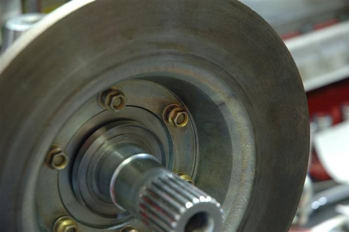

David Kirkham 09-03-2007 04:00 PM
Now you need to bolt your drive pins back on. (You don't have to do this on the latest Kirkham cars as we milled the drive pins directly into the hubs. :D )
Notice we use all metal aviation jet nuts here rated at 190,000 psi. Just say NO to nylon in high temperature applications! It doesn't do your nuts any good if the nylon melts out of them.
http://www.clubcobra.com/photopost/d...06_Medium_.JPG

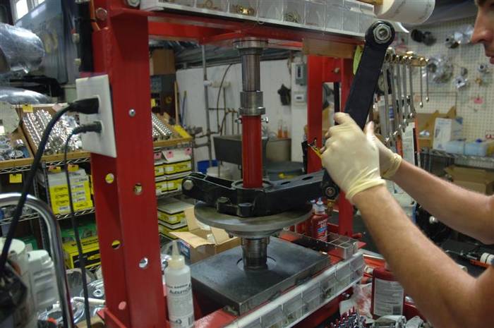

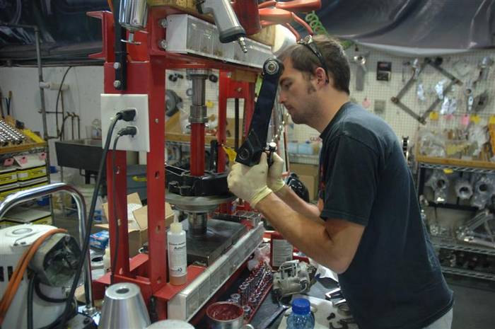

David Kirkham 09-03-2007 04:04 PM
Now you have to put everything back together. It is very tricky and you have to do it in the right order or you will end up in a mess.
First we put the outer bearing on the hub and rotor assembly. Then we put the upright back on the hub as far as it will go. Then you need to have a special tube pressing tool (like the one we have shown here) that will push on the RACE of the inner bearing. Press down on the race of the inner bearing until everything stops and then HOLD the press down. While you are doing this, you MUST move the upright back and forth on the bearings to make sure nothing gets caught or binds up.
http://www.clubcobra.com/photopost/d...09_Medium_.JPG

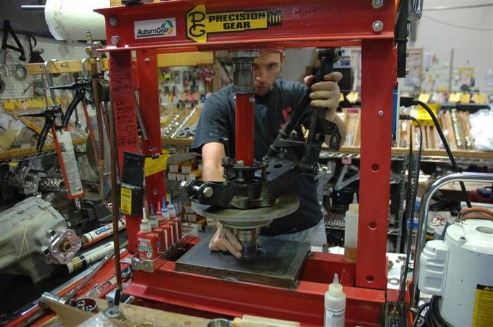

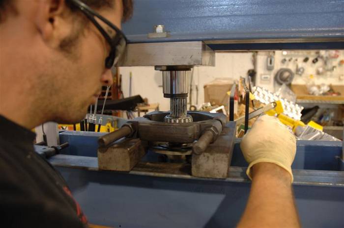

David Kirkham 09-03-2007 04:07 PM
While the hub is locked down in the press, Sandwich tries to move the upright up and down to make sure there is NO play in the upright. At the same time, he is making sure there is about 25 inch pounds of drag on the preload of the bearings by rotating the upright side to side. Finally, he gives the assembly a 360 degree turn to make sure nothing is caught or binding up all the way around. It is all quite a delicate dance, but with experience it is definitely easier to do.
http://www.clubcobra.com/photopost/d...10_Medium_.JPG
David Kirkham 09-03-2007 04:09 PM
Here is another view of Sandwich doing his magic on the press. Turns out his educated guess measurement of 0.004 inches was right.
