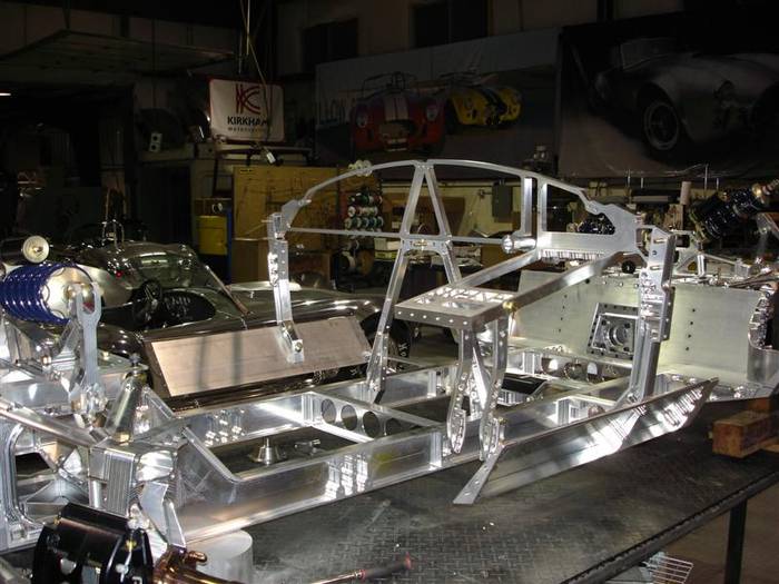

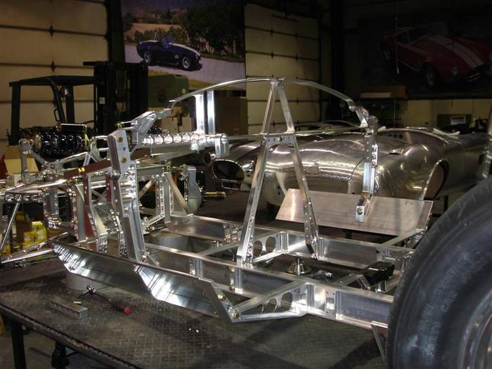

Here you can see the side door sils going on. This is another one of the keys to the stiffness of the chassis. Here you can also see the cowl "hoop" and the door pillars have been mounted on.
