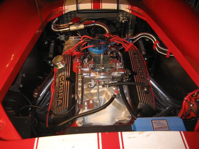

One other point; if your engine does not have a closed PCV system in place, you probably won't get past the BAR referee.
Good luck.
Paul F 07-22-2011 04:24 PM
You are well on your way with the sequence number in hand. It is just a matter of time now.
tcrist 07-22-2011 04:33 PM
What do you mean by "closed PCV system"?
It has a PCV valve in the valve cover and the hose runs to the back/base of the carb.
bingo2 07-22-2011 05:43 PM
That's half of the system; you should have another breather on the other valve cover with a hose that provides clean air for the system. That hose is usually connected to the base of the air cleaner.
See this example; http://ww2.justanswer.com/uploads/su..._pcv_valve.gif
tcrist 07-22-2011 07:23 PM
Well, I do have a "slip on" oil filler on the other valve cover. I guess I can get the items needed, modify the breather and that should work.
Thanks Bingo2.
tcrist 07-23-2011 02:38 PM
My oil filler has a filtered breather cap on it. Do I need to change it to hook up to the air filter also?
http://www.clubcobra.com/photopost/d...757_Small_.JPG
bingo2 07-23-2011 08:21 PM
I can't say if your setup would pass or not. The example I provided is the exact one the BAR Referee provided to me and it depicts air drawn from the air filter housing. Whether or not the referee would consider the breather as providing filtered air to the system, who knows.
tcrist 08-19-2011 03:15 PM
Today I have my SB100 sticker on my car. Nice guys down there at the BAR at MJC west.
Bingo2, My setup would NOT have passed. That is the first thing that they checked. The guy asked if I had something like a stage 4 PCV, or something like that. I showed him what I had done and he just smiled and said "perfect". Less than 45 minuites later and I was out the door with a handshake, SB100 and nice comments like, I wish everybody came in prepaired like you. Everything they asked for I had right there. Of course they did not really ask for too much, but I had it.
