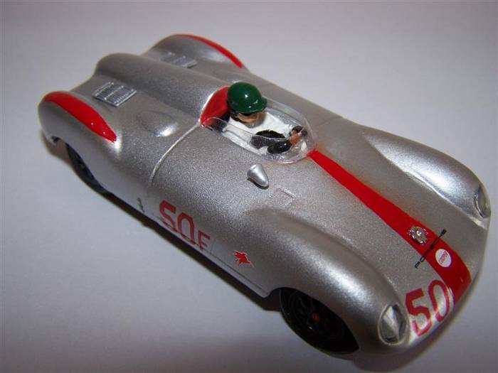

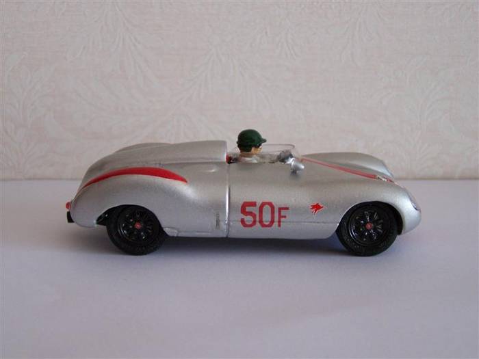

PDHse 10-30-2008 06:51 AM
Well i finished my model of the Porsche Cooper R3, not easy but good fun.
I had a go at pinstriping on a pane of glass and seemed reasonably easy as your fingers steady your hand as you paint. It helps when its a nice smooth surface.
So why did i go to these lenghts to paint a little model with bumps on :confused:.... anyway the end result is not perfect but its not bad.
To be honest, back in the day some of these cars did not have perfect paint jobs anyway.
The 1 shot tin had warning signs all over it so i thought i,d better pinstripe in the garden and not my usual place of model making (kitchen).
Even outside and with a pot of thinners for my brush to dip into i felt a bit light headed, not recommended.
What do you guys think of my model?
Paul
http://www.clubcobra.com/photopost/d...100_1650-1.jpg
http://www.clubcobra.com/photopost/d...100_1666-1.jpg
http://www.clubcobra.com/photopost/d...100_1647-1.jpg
Jamo 10-30-2008 10:30 AM
Muy goodo...asspecially given the scale!

VRM 10-30-2008 12:47 PM
Nice Pooper (Porsche/Cooper)! You did the stripes and numbers a helluva lot better than I would have been able to do with a brush! I would have had to print decals, and they would have looked like printed decals. The numbers especially look very 'in-period'.
