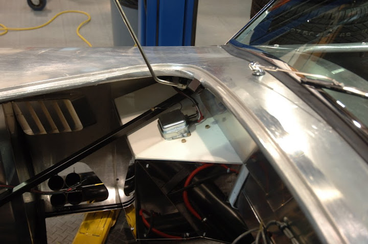

LMH 04-02-2010 09:30 PM
Here's one of a Kirkham.
http://lh4.ggpht.com/_Zo5O7Eow6M4/Rs.../s720/KMS_1645
dlampe 04-03-2010 07:27 AM
Now I understand!

mickmate 04-03-2010 06:33 PM
It has a 1/4" screw that holds it to the tab coming off the birdcage. The tabs are the same as the hood and trunk hinge brackets.
http://img405.imageshack.us/img405/4537/proprod1.jpg
http://img130.imageshack.us/img130/1083/proprod.jpg
