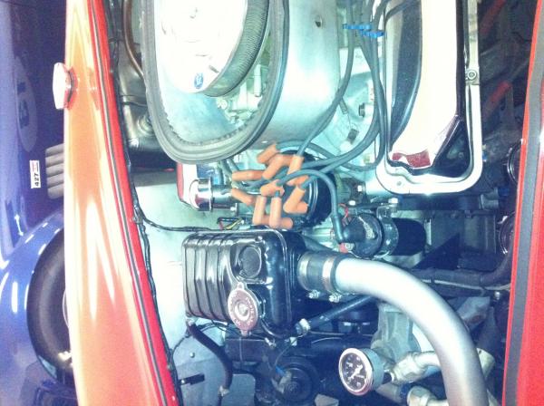

I can take a picture of my engine and post it if it would help
gthompson 12-05-2012 08:09 PM
http://www.clubcobra.com/forums/pict...pictureid=8998
Obsessive 12-05-2012 08:37 PM
That's some kinda fantasy garage you've got there gthompson. Wow.
mickmate 12-06-2012 03:34 AM
Hi George, thanks for that. I see yours doesn't have the Galaxy filter on the front of that head. That makes more room there for the coil and makes me wonder what is correct for fuel filter for comps or if it all comes back to the as "built" deal with these cars.

gthompson 12-06-2012 05:57 AM
No problem
Let me know if you need any other pictures of anything on the engine
