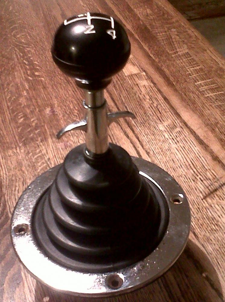

1985 CCX 04-17-2013 02:05 PM
This is mine, early T-handle as well................
http://www.clubcobra.com/forums/pict...pictureid=9921

CompClassics 04-17-2013 05:06 PM
1 Attachment(s)
8 1/2" from mounting flange base to the end of knob threads:
