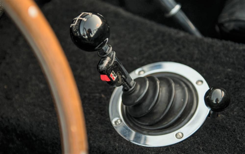

This is the gearshift on CSX2075
http://www.clubcobra.com/forums/pict...ictureid=17049
Two questions...
What is the knob just behind the shift lever?
What is the gadget/switch attached to the shift lever?

The red button is called a roll control or line lock. It locks the front brakes only so you can take your foot off the brake pedal and work the clutch and gas. Makes it easy start on a hill, or stage at the drag strip. Also fun for cool smokey burn outs.
Not sure what the other knob is for.

The other lever is a reverse lockout for actuating reverse so you could not accidentally shift into reverse when you were intending to shift into first. I believe Hurst manufactured both items. That particular shifter mechanism was for a four speed transmission and a popular upgrade for race use beginning in the mid to late 60's although there were people who also used them on the street.
