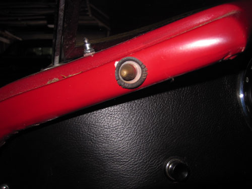

Dan Case 01-11-2018 10:43 AM
CSX2034 and a brass pin installation
http://www.clubcobra.com/photopost/d...CSX2034-36.jpg
