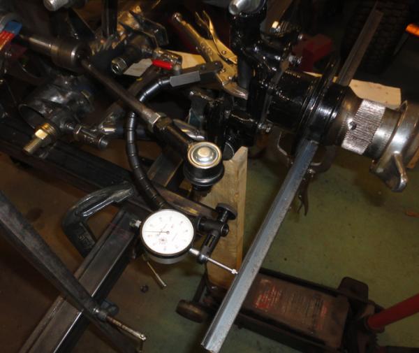

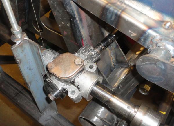

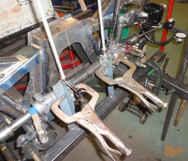

I did manage to get the steering sorted, those little adjustments took more time than I expected and I did revamp my fixture holding the rack with some threaded rod for easier and more precise vertical adjustments and improved my setup for checking the bump steer. With the dial indicator clamped to the king pin and indicating at about one foot from hub center I can watch the change as I move the arms through their travel with my trusty floor jack.
http://www.clubcobra.com/forums/pict...ictureid=19990
http://www.clubcobra.com/forums/pict...ictureid=19991

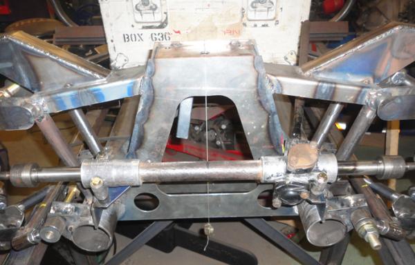

In the end I found a very happy spot, more forward then I had thought but it ended up about half an inch further forward and an inch lower than the original chassis had it mounted and that’s OK clearance wise so we will go with it.
What it really all means is from theoretical ride height it toes out about .003 in the first inch and in the second and third inches it gets to about .025 progressively so I think that will be quite manageable and predictable. I got the same on both sides and it’s quite repeatable so I am sure it is not a fluke. I did a small celebration dance and moved on…

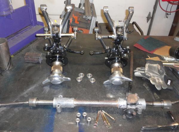

I then remounted the rack so the steering shaft was facing the right way and had to clearance the main tower a bit to get it back in the right spot, nothing to radical and after a couple of refits I like it.

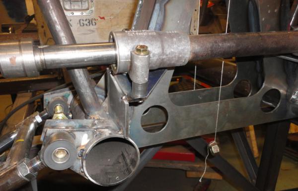

http://www.clubcobra.com/forums/pict...ictureid=19992
http://www.clubcobra.com/forums/pict...ictureid=19993

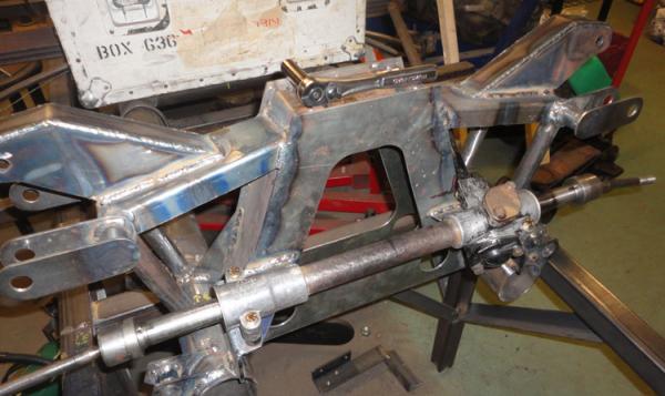

Then on to brackets, I used the same angle as the original mounts and made the appropriate spacers. Then using CAD again, made up some modified original style mountings from 3/16 plate and tacked it all up….
http://www.clubcobra.com/forums/pict...ictureid=19994
http://www.clubcobra.com/forums/pict...ictureid=19995
http://www.clubcobra.com/forums/pict...ictureid=19996
Then I took everything back off and got down to some welding.
In the end I re-mounted the rack and ….good news……. is it still fits perfectly

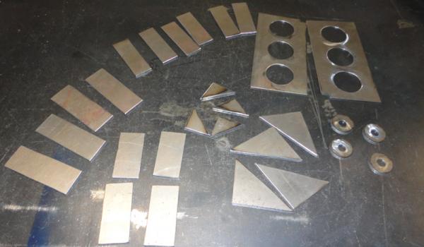

Now on to finishing up all the little bits on the front and most of the major welding so after another after noon in the shop with steel and grinders I give you ……..
Gussetpaloozza!
http://www.clubcobra.com/forums/pict...ictureid=20001
Hopefully next time I will have them all welded in place and be moving on to the engine mount towers and such things. But that’s enough for now….

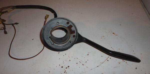

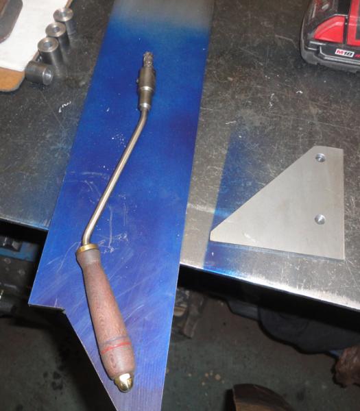

In other news my SWF turn switch arrived and looks good.
http://www.clubcobra.com/forums/pict...ictureid=20002
A quick check with the multi-meter says all the switches are working correctly so I will freshen it up at some point in the future and check it off my parts list.

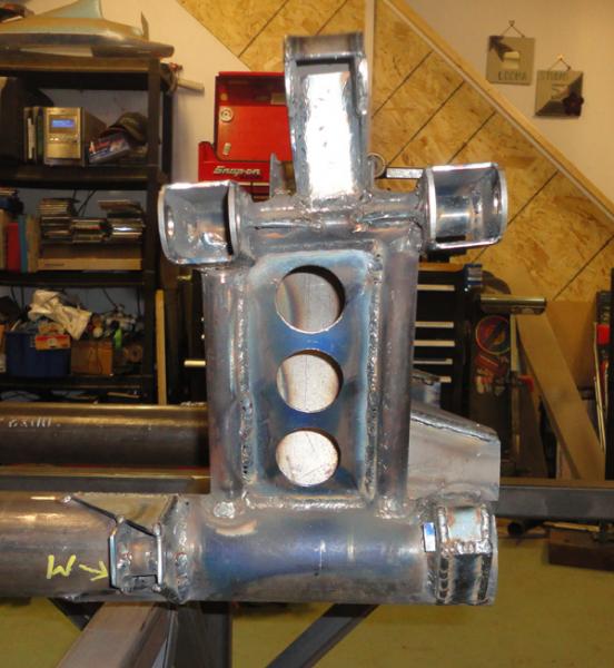

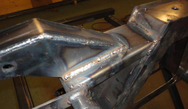

I did get down to solidly welding up the front with all the various gussets and such. These things always take more time than you think they will :p.

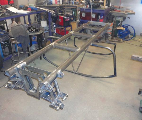

I also need to report that my roadster has had a “roll over” incident right in the shop! :eek::eek:
http://www.clubcobra.com/forums/pict...ictureid=20058
Fortunately no one was hurt :rolleyes:, and honestly it made welding up a bunch of the bottom stuff both front and back a whole lot easier, a welding teacher years ago told me never to weld “out of position” if you can avoid it, so that’s what I did.
The chassis dropped right back into position perfectly on the table when I was done and I am sure this won’t be the last time I flip it over for welding purposes.
And on a side note, surprisingly I can still pick the chassis up off the floor by myself…. I am sure that won’t be the case in the end…..
With the gusset plates in the front suspension mounts I think it looks very 427 like from the side view….hmmmm
http://www.clubcobra.com/forums/pict...ictureid=20057
After all that my original plan was to get right to the engine mounts! but upon looking around at my growing collection of pieces I thought it was a better idea to finish up the suspension arms, not more fun, but a better idea :LOL:.
Everything was tacked but I knew that later on I will be happier if I can just pick them up again and bolt them in place finished. Also with spring coming and potential moisture issues I did not want to risk the areas I need to weld getting corroded :mad:.
So they are done now, all the gussets and all the many anti rotation tabs on the arms and chassis mounts, all done…it’s a good feeling :D.
I then went around the chassis and re-fit the arms again and tweaked the arms and mounts for a proper fit.
The heat of welding always does strange things to steel structure as it cools and I had a few little issues ;).
I found it most noticeable in the front upper mounts as there were a couple of points with clusters of welds coming together, but then out came my trusty old Henrob torch and some ½ inch threaded rod and nuts. I managed to normalize the offending areas and push and pull things back where they should be. Again so I have fewer issues later.
It’s a bunch of fiddly work but not much to take pictures of, it really doesn’t look much different, it’s only when you fit the pieces together that you can really tell.

This weekend I got out to the lab and decided it was time to try and make the rear out rigger box assemblies! It’s a nice folded up design and I am sure AC cars had handy templates made but I figured I had 2 options.
I could try and do it in one folded piece of steel or I could cheat and cut out the parts and weld them together at the corners.
Well I am pleased to say after a bit of back and forth I managed to get a working layout and bent up the very interesting tapered box sections for the back.
http://www.clubcobra.com/photopost/d...gger_parts.jpg
Looking at the flanges I assume AC cars spot welded them together but I don’t have one of those so some 5/16 holes and plug welds will be close enough for me. It always amazes me how strong this type of structure is, a flat piece of 16 gauge steel is rather flexible but put a couple of bends in it and voilà! Strength!
http://www.clubcobra.com/photopost/d.../spot_weld.jpg
I added the endplates and welded everything up. I thought it would be nice to end today on a good note so I rechecked the measurements, cleaned up and tack welded the outriggers to the chassis!
http://www.clubcobra.com/photopost/d...ers_tacked.jpg
The only thing I don’t currently like is that the outer seat belt mounts just weld to the thin end of this structure.
I think I will add a bit more reinforcement when I add them later but for now it feels good to be adding pieces outward from the chassis, soon there might even be a floor or something!
