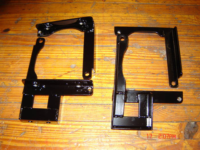

Here are photos of my set up and the brackets I made......
EarlsflyinCobra 06-29-2010 01:22 PM
I'll try and find more of them in the car........
EarlsflyinCobra 06-29-2010 01:37 PM
Here is another photo.............

Earl- why two tanks ?
And, can you take closer shots like the last you posted ?
What length is the tank, and the total length ?

Both are 2 quart units, one is the pre-oiler and the other is the after oiler for the turbos (2).....both have check valves and the pre oiler has an electric valve. Still looking for more pics.......Earl
