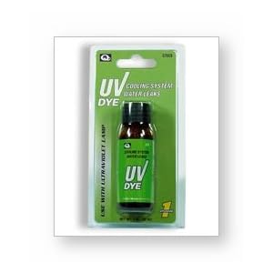

Put this in your coolant and then, from time to time, put the UV light on the water pump area, the hoses, the bypass hose, and when you see the glow, you will have found it. It's totally harmless to leave in there, btw (unless you're using Dex-Cool).
Cooling System UV Dye, 1 oz. (375CS) : Amazon.com : Automotive
