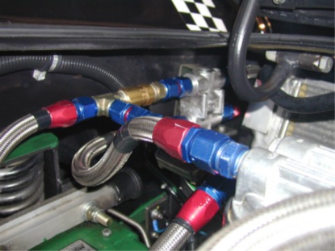

Roscoe 03-20-2002 04:22 PM
This is how I have mine setup.
http://www.priveye.com/images/Therm.JPG
http://www.priveye.com/images/Therm3.JPG
