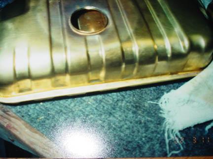

427SSSS 02-27-2003 10:50 AM
I was sent to Frey Racing, to have tabs welded onto alum radiator, but Frey closed up their fab shop and are moving their store to Scott Creek Road at Milpitas/Fremont border.
So I drove around the industrial park on a wim and
I found (stumbled across his shop by luck) a one man welding shop:
NUNEZ PRECISION WELDING
Carlos G. Nunez President
1763 Houret Court
Milpitas, California 95035
408 263-9503 Cell 408 690 2272
He welded tabs on my Gordon Levy Radiator(I know Gordon says you don't need tabs, but, but, but), and did a beautyful job on welding the aluminum.
The particular connection I was concerned with, he tig welded using brass rod, and it came out fantastic! I took a picture, but I'm at the wrong computer to be able to post right now, I'll post when I get home tonight.
I tried to sodder the rest of the connections together last night, now I've done alot of copper plumbing soddering, but I could not get enough heat to make a good looking connection, probably me, maybe old equip. I gave up, cleaned up what I had messed up, and it's back at Carlos's shop right now, as I'm typing this, he said he would try silver sodder, and if that did not work well, he would tig weld with brass rod, it will be ready at noon.

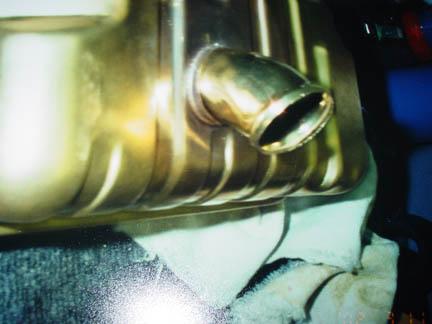

427SSSS 02-27-2003 05:15 PM
[IMG]http://www.clubcobra.com/photopost/d...-008-thumb.jpg[/IMG]

Steve R 02-27-2003 06:35 PM
Wayne,
I hope you don't mind, I took the liberty of reposting your picture of that bad boy ;)
http://www.clubcobra.com/photopost/d...27-008-med.jpg
Steven
427SSSS 02-27-2003 08:30 PM
Steven,
Now I understand what you were doing with the first pics you posted, I had tunnel vision, just trying to get clear how to do the connection you posted in your last two pics, man that must be some camera you have.
As I said the welder use TIG with a brass rod.
No I don't mind at all you enlarging the picture, glad you appreciate her, (I'm assuming you mean the engine not the surge tank when you said: "bad boy"), :) ain't nothing like a BB. And she has never been bored, a true S/O casting (Oil passage not drilled), per Mike.
