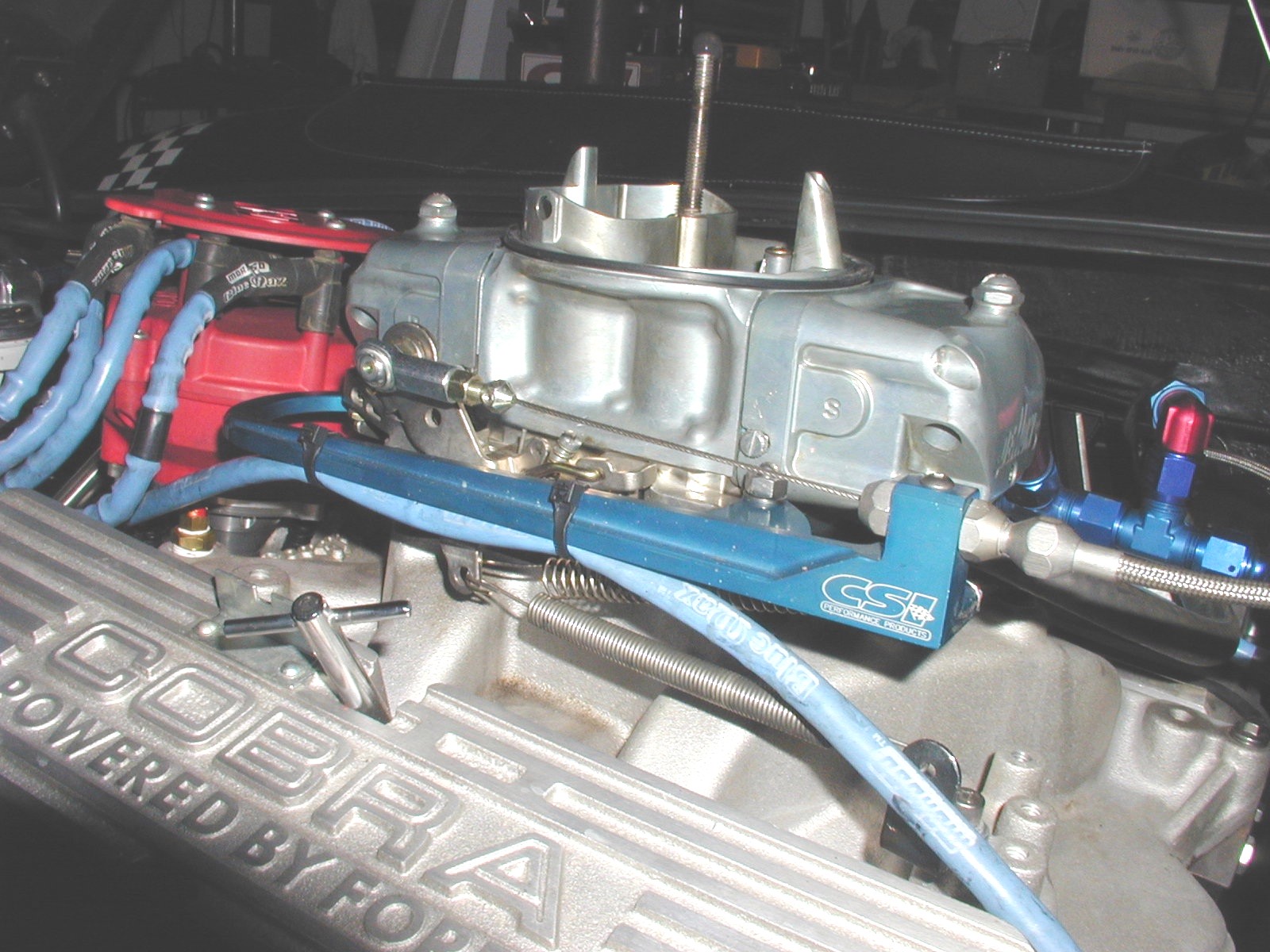

Roscoe 01-26-2004 01:18 PM
Bracket by CSI and Lokar cable work perfectly together.
http://www.priveye.com/dls/linkage.jpg
Roscoe
mzhun 01-26-2004 01:58 PM
Thanks! I just went on Jegs and found it. I see your fuel line running out the back, do you have an elec. fuel pump?
Roscoe 01-26-2004 02:01 PM
I've got the BG fuel log that runs along side and down to the bellhousing area, along the chassis to a filter and to the elec Holley black pump just under the drivers seat.
