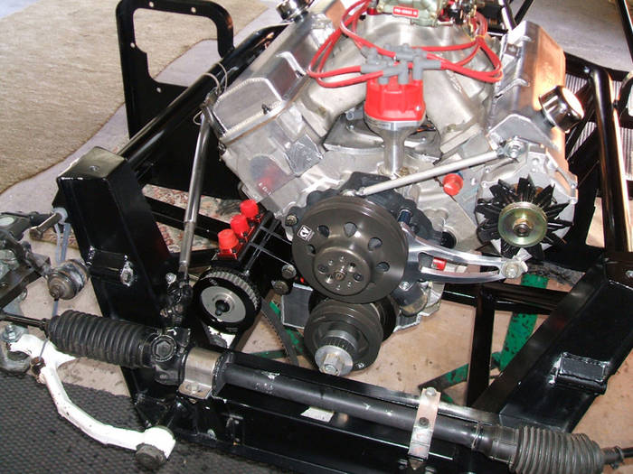

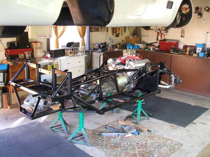

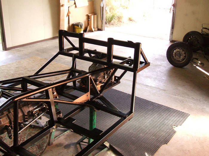

jmarsey 11-30-2006 09:48 PM
Ant's Monster
Ok Ant,
You are probably much farther along now. Hope you don't mind. I just think folks should see this thing. Here you go:
http://www.clubcobra.com/photopost/d..._monster_3.jpg
http://www.clubcobra.com/photopost/d..._monster_1.jpg
http://www.clubcobra.com/photopost/d..._monster_2.jpg
I know what you're going through and I admire your discipline.
Talk soon, John
