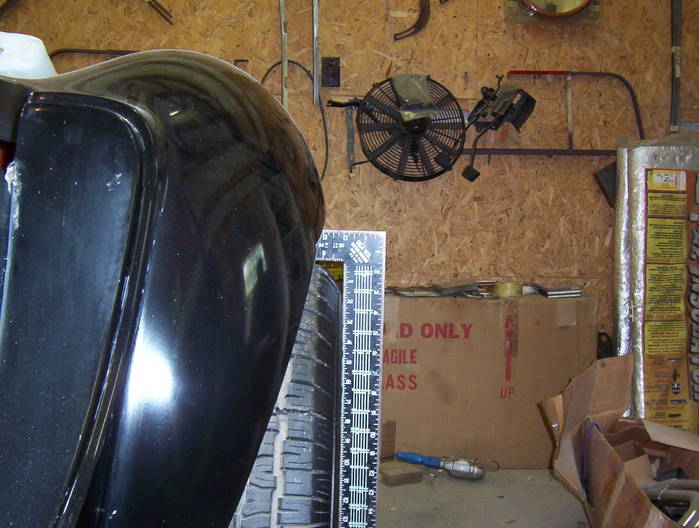

How much do I need to narrow my 8.8 rearend
Its a 8.8 rearend from a 88 mustang LX.The wheels are team III with all the offset thay recommended the tires are 265-15-50
"if this works":confused:
from these photos how much would you say I need to narrow this rearend.
there are some more photos in my gallery from underneath the car if it helps.
I have seen threads here about using a rear from a explorer, would that be a better route to solve my problem?
Thanks for any help
http://www.clubcobra.com/photopost/d...m/100_0199.JPG
B L & sons 10-10-2007 06:23 AM
http://www.clubcobra.com/photopost/d...m/100_0200.JPG

I looked at your gallery, and if you remove the quad shocks, you can narrow it a little , but I believe that you don't have a lot of room with your set up.
And 8.8 axles can't be cut down because they use C clips---if you do narrow the rear convert to a Torino type housing end to eliminate the c clips and upgrade to 31 spline axles
Jerry
Rick Parker 10-10-2007 07:13 AM
3.5"-4"
The better way to do it is remove the entire axle assembly from the car. Stand the tires up vertically and locate them in the wheel wells the way you want them. Then crawl under the car and measure the distance between the wheel mounting surfaces. Use this dimension to resize the existing axle assy, or resize any other axle you may choose.

Looks like the way to go is by what Rick has recommended .The rear has to come out one way or the other.After it is out I will measure from inside fender lip left to right.would any of you konw what the normal measurement should be? give or take

You can narrow an 8.8" about 4" overall. I had mine narrowed that much without a problem. Anything more and they have to start messing with the lower control arm mounts.
I also had to remove the quad shocks. I put the earlier traction style bars on. I used a set of Mosley axles. You can get 28 or 31 spline in whatever length you want for about $250 for the set and you can get them with C-clip style if you prefer. I used the axle flanges from a 94-95 Mustang so I could use the disk brakes. If you do not request this modification, they will give you axles from 93 and earlier and if you run disks in the rear, you will have to make an adapter for the rotor.
As for length, all the housings are the same except for some housing out of a T-Bird/Cougar with drums and 96-newer Mustangs. The axles were changed in 94-95 model Mustangs to accomodate the rear disks and anti-lock ring, but the housings were the same.

I also had Team III wheels custom backspace to fit my narrowed '95 Mustang GT 8.8 rear. I took it to Moser in Indiana and had them take out all they could (including space for the quad shocks) and leave the stock mountings for the lower control arms. I believe they only took out 2.5-2.675" per side. I also had to buy new Moser axles because that year 8.8 axles neck down off the splines and could not be re-splined. it turned out well, though.
