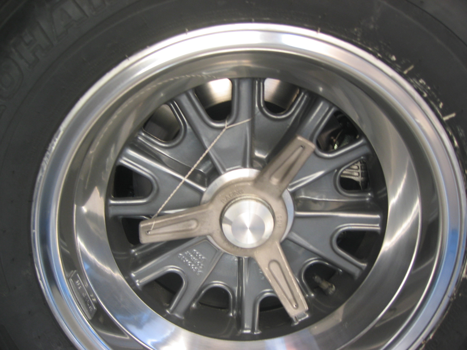

patrickt 10-29-2007 01:08 PM
Originally Posted by 65cobra1
Just curious but did you mean you safety wire TWO ears?
I only safety wire one, as you can see below, but if I had a second wire going to one of the other two "ears" of the spinner, I think that is what he meant.

JBo 10-30-2007 05:33 AM
safety wire two ears and use a safety wire tool . Make the wire relatively tight. Safety wire is not designed to be a "tell" of a loose knock on, but to PREVENT a knock on from "walking" off
patrickt 10-30-2007 06:22 AM
Originally Posted by JBo
... but to PREVENT a knock on from "walking" off
"Walking," as opposed to "wiggling.";)
