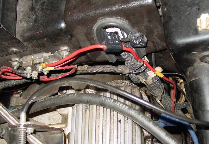

Thanks for all the suggestions. I'll check the ground wires, and rewire and run a 20 minute test to see if the wiring gets hot. I'll also post a high-res picture in my gallery to show how the fan gets power (and to show the fuse damage). The fan is powered straight from the main circuit breaker and bypasses the fuse block. I did that when I did my "custom" wiring because the power draw of the fan through the fuse block as originally wired did cause problems in the block.

Hopefully, this link will embed in the message:
http://www.clubcobra.com/photopost/d...ng-failure.jpg

How many curcuits are on that curcuit breaker?
jwinkler JL how many curcuits are on that breaker? what amperage is it? If you over power that breaker you will have it go on and off from the load (amps) being to much. This will smoke the connections in the fuse holder. When the load to the fan kicks on, first the spikes amperage, then the steady pull on the curcuit, The contacts in the fuse holder get hot and spread apart. More resistance happens and you have melted wiring. I also hope there is a fan relay for turning on and off the fans. 30 amp is ok 40 amp would be better. I have 2 of the fuse holders you are showing. I use one for each of my fuel pumps in the car. Even though the wiring is heavy the contacts are light duty in the plastic. IMO I wouldn't run more than a 20 amp curcuit to one accessory with these holders. Yes I have melted them too. Yes I did stay at a holiday inn and work under the 1/8 moon shining, repairing a wiring harness for a friend. Old days no problem with that fuse holder, today cheap metal for the contacts. Some contacts are only copper coated, not solid. %/:) Rick L.

One question was the rubber cap on that fuse holder checked recently? Once it's replaced check for heating of any of the wiring to the fans under load. Doesn't sound like anything outside of the fuse holder caused the meltdown. If you can find one get the larger style blade fuse and holder (about an inch long) the blades on the standard fuse are too wimpy on a 30A circuit. If you can dig that fuse out you'll see one of the connectors overheated.
