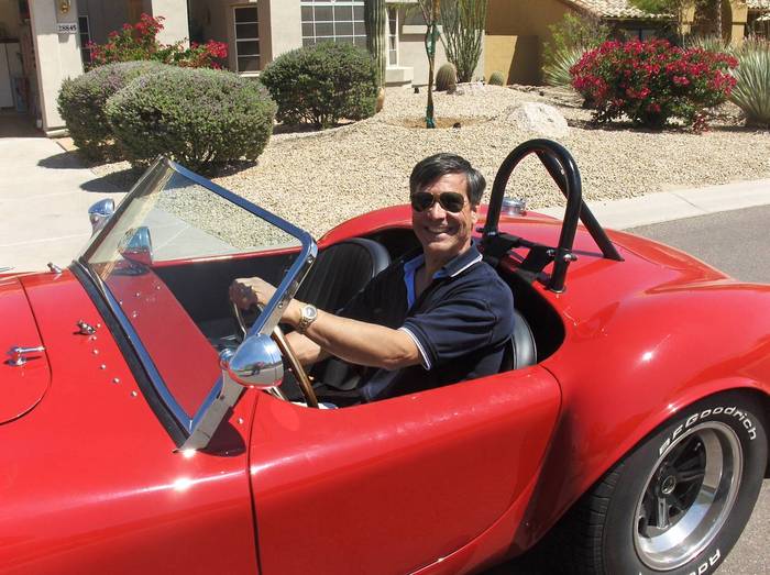

1985 CCX 06-05-2008 04:15 PM
Here is my friend Doug in John's fabulous carbon fiber car!
See attachemnt for both comp and street on dash.
http://www.clubcobra.com/photopost/d...767_jockey.JPG

vector1 06-05-2008 08:13 PM
that is what i was looking to do. what type fasteners were used for the comp windshield?
