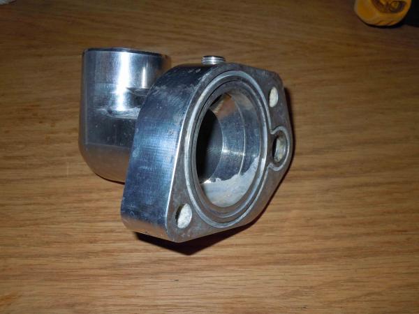

WardL 10-20-2010 09:47 PM
http://www.clubcobra.com/forums/pict...pictureid=4388
I haven't quite mastered pictures yet, but this is supposed to be a picture of the thermostat housing. It is also in my first photo gallery if it doesn't come up here. The flanges are pretty thick. Does anyone use the round "O" ring type gasket with this? You can see the groove in the face.

bobcowan 10-21-2010 07:45 AM
This is what I use. I pitched the O ring a long time ago. Permatex red silicone only.
CobraEd 10-21-2010 08:01 AM
The Mr Gasket housing that I use has the exact same modified O ring. Never leaks.

timsullivan 10-23-2010 08:12 PM
What brand is that thermostat housing?
Ward: Who makes the thermostat housing in your picture?
-Tim
akfish 02-02-2012 11:50 AM
^^^ I'd also like to know, I think it's from roush, I've called roush 4 times in the last 3 days......no reply.
