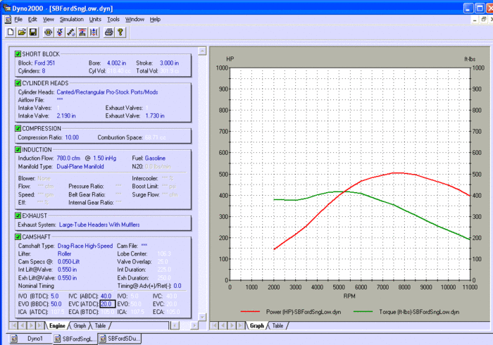

http://www.clubcobra.com/photopost/d...m/302_dyno.gif
This is what I come up with on my dyno simulation program.
I used the best heads I had available. I assume 4V Cleveland or Boss style heads that morphed into ported NASCAR heads. As I said keep valve overlap minimal. I used a dual plane to keep the bottom end up, which did hurt the top end, compared to a single plane. I did not cheat and use open headers. The mufflers killed a 100 hp and forced more cam (especially on the exhaust) to get the top end. Duration is 225 intake and 250 exhaust @ 0.050" lift. Yes a very wide pattern split.
As you can see the bottom end torque is very respectable in the 375 lb-ft range, and overall fairly flat. 381 lb-ft at 2000 rpm is not going to be a total dog in the bottom end. The hp peaks around 7500 rpm at 506 hp, and is relatively flat from 7500 to 8500 rpm. 496 hp at 8500 rpm is only down 10 hp from the peak.
I suspect building a real engine to these specs would not actually produce the same results. Who knows if it would even be in the same ball park.

I would agree with that 100%. Add volume and flow, but take away velocity, and you end up with a port carrying a lot of inertia. A "slow" port is hard to get moving and is considered lazy until the higher rpms. If you don't have enough cam, it doesn't matter how well the heads flow, it won't pull the rpms that you want. It's true that you need less duration as head flow increases, but that doesn't mean that you can have a 600cfm head and a 205° duration and spin to 7000. (Just for example's sake...)
The dyno sims are a great "ballpark" tool. Unfortunately, Desktop Dyno and EA Pro show about 7-8% high compared to the actual dyno that I use. Desktop Dyno seems to be WAY off when it comes to torque numbers as well.
There's NO way that a 302 set to peak at 7000-7500 will have a flat torque curve settling around 400 lb-ft. An't no way. An't gonna happen.
You also have to look at it this way....dynos are cool for breaking in an engine and seeing what kind of power it puts down, but at the end of the day, you can't get on it and drive it. A dyno gives no indication whatsoever as to how the engine will be on the road, in a car, with a transmission and rearend behind it. It gives no indication of how much you'll have to slip the clutch taking off or how fussy it will be cruising at 1500 rpm.
What you would see in reality with this type of combination would be a torque peak at around 6000 rpm, with probably around 100-150 lb-ft available at cruising rpms. The curves would look more like a steep hill instead of having any flatness to them at all.
