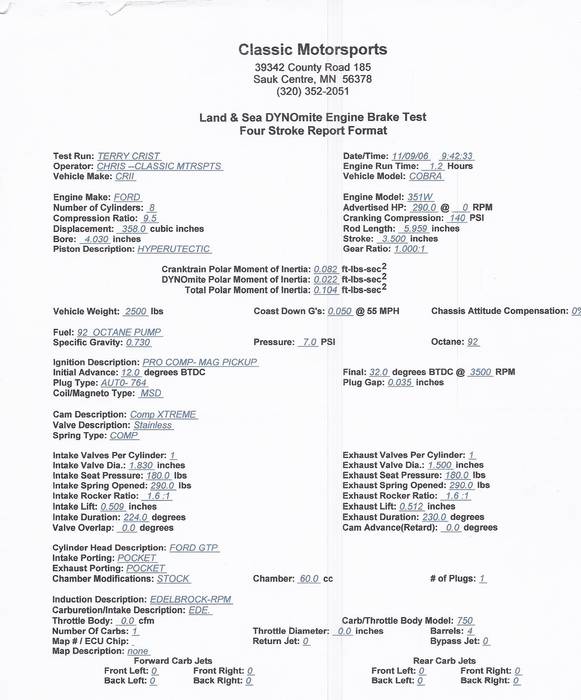

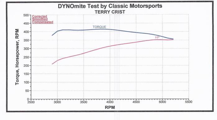

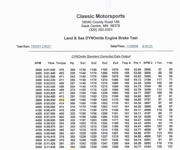

tcrist 02-28-2013 10:03 PM
Ok, Cropped them and that did help.
http://www.clubcobra.com/photopost/d.../Scan00051.jpg
http://www.clubcobra.com/photopost/d.../Scan00061.jpg
http://www.clubcobra.com/photopost/d...dium/dyno4.jpg
AL427SBF 03-01-2013 07:31 AM
I like your torque curve, pretty flat/smooth in the 3K-4.7K range, makes the mountain twisties manageable and fun. No Dolly Parton there, but I see a little Jennifer Lopez :LOL:
