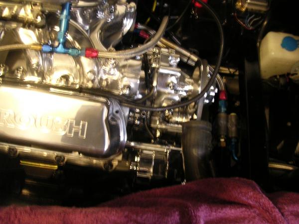

madmaxx 02-18-2014 06:59 AM
Best i could do without a flash on. as you can see i still have some assembly but it is mind numbing to look at in person.
