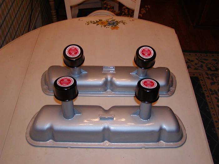

Or, if you want to save some money, here's a "cross over" method. We use this on our sprint car. Road racing would work the same way.

I have had similar results with my 351-W........What I did was add/weld about six inches of thin walled steel tubing, I think about 1.25 inches in diameter to the breather holes,but when you weld them in,set them so they are straight up (vertical) on the valve cover when the motor is installed in the car, also I added a baffle,nothing more than a small piece of Z-71 rear quarter panel in the shape of a V, I inverted the V and put it in the tube from the bottom and welded the two ends in the tube,solved all my problems.........
Got the idea from the original 289 Comp car vavle covers.......what was happening was the vent worked great,but after shut down a little oil/mist "pooled" in the K&N breather and since it was at an angle it dripped out the side of the breather element on the headers instead of draining straight down back into the engine........
I have seen pics of the old 289 comp car vavle covers,but can not find one now,maybe computerworks can find the photo and post it,it will give you an idea of what I'm talking about............
notice the photo FUNFER2 posted and you will see the vent tubes with the breathers stand straight up,so things drain straight down back into the system and not all over your motor........mine are very similar,except I welded a tube to each vavle cover coming straight up and use similar breathers.......

Gt350 Type[IMG]http://www.clubcobra.com/photopost/d...icture_405.jpg[/IMG]
Cobra FIA type:
[IMG]http://www.clubcobra.com/photopost/d...86P1010135.JPG[/IMG]
One of the problems the 289/302 encounters is the comparatively small crankcase has difficulty venting when the engine is in a stroker configuration. A small piece of fuel cell foam stuffed into the vent tube on the valve covers will prevent the oil spray & vapor from escaping under high rpm. THis works well.
[IMG]http://www.clubcobra.com/photopost/d...010135-med.JPG [/IMG]
The GT 350 Type came after the ones with 2 vents on each cover. I'm not sure why they only used 1 vent per cover????
Flash!!! Information was forwarded to me from Cal Metal who was able to have this clarified by Phil Remington. His response was that the ring sealing technology and materials had improved to the point that there was considerably less blowby and consequently only one vent tube per bank was required.

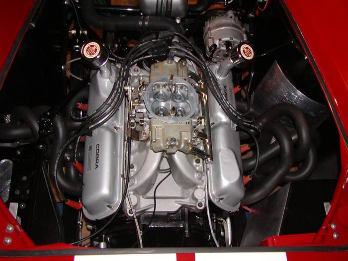

Thanks for all the ideas. I ended up ordered a new set of valve covers without any holes, then a Moroso kit that is everything you need for the "Cross Breathers" that FUNFER2 suggested. Motoro makes a kit for this (part # 68762).

autoxmike 06-05-2006 01:52 PM
Just stumbled across this older thread that I started. Thought I would post a picture of the final breather arrangement.
