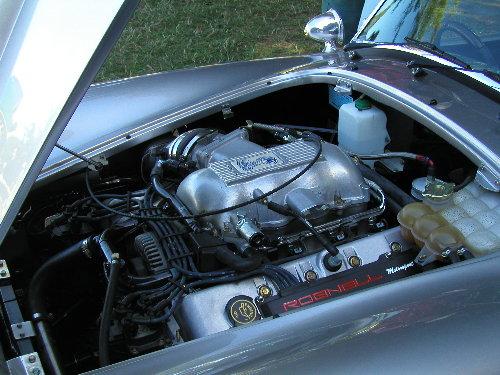

OZCOBRA 04-01-2010 05:50 AM
Here's one from a few years ago...I have got a few supercharged 4.6 pic's i'll just have to find'em...
http://www.clubcobra.com/photopost/d...78P2170030.jpgStandard scoop on this car!!
http://www.clubcobra.com/photopost/d...Dale_Benge.jpgyou supercharge it so it hangs out of the bonnet a little ...then you no longer need to worry about scoops and cowls!!!!
