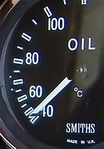

I noticed the oil and water temperature guages have a dot just below and just above 70 Celsius as if to indicate this is the normal operating temperature. This is only 160 Fahrenheit and well below what I have setup my car to run at which is 90 to 100 Celsius for both oil and water. Just an observation on my part, welcome any comments.

The two dots above and below 70 degrees mean absolutely nothing. Ignore them.
http://www.clubcobra.com/photopost/data/500/dot001.jpg
