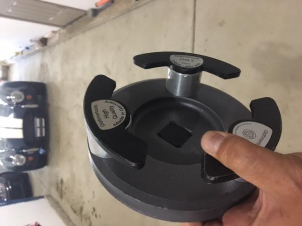

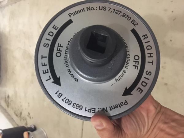

GLS-BDR226 11-25-2016 08:31 AM
Where did you get this tool? Thanks.
Mark IV 11-25-2016 09:10 AM
https://www.oldtimertools.de/Vehicle...AND-CHA-3.html
If you have a "stuck" spinner this will likely not work even with a high power impact wrench which would also likely hammer-out the center of the tool as well.
