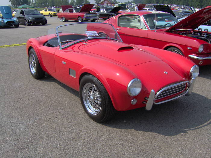

Hey Guys,
I am trying to find the proper location of the front "cobra" emblem. The SCOF sight indicates 9.5" up from radiator open and ERA drawing indicates 10.75 inches from hood opening. ERA has the emblem in line with headlights or there abouts, is there any set rule? The ERA sits more to the front of the hood. Where did the value on SCOF come from?

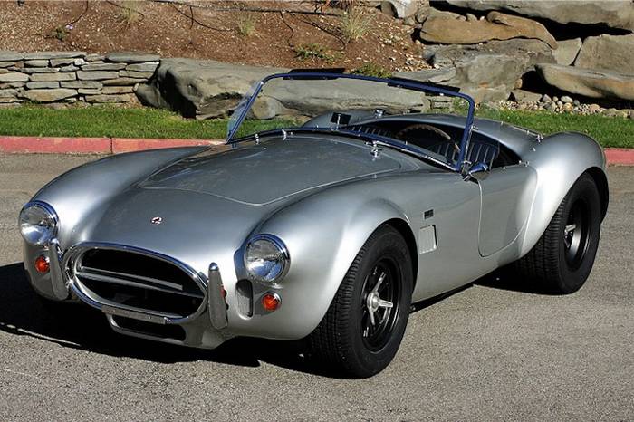

Contemporary Classic is 8 7/8" from the opening to the bottom of the emblem.

Sharp eye for details! I just looked through a few books, SAI looks to have placed them on the lower half of the front end. COB, COX, and Autokraft (with exceptions) look to be centered. Oddly enough there are a few restored 3000 cars that look to have a centered emblem. As with all these cars there are always exceptions.........:)

I looked at all the ones on club cobra and cobra country, some hood emblems are high some are low, all look good!!! I will probably opt for the high one or 9.5" from the opening. The reason being if I get 3m paint protection I would not want the paint protection any higher on the car. Oltoff was super nice and said 9.5" from the opening which matched the SCOF instructions, good tip, I guess I could have called Dynamic.

I have a PDF document, drawn by Stephen Bramlitt (Owner of Reno Engine & Drivetrain - SPF engine build specialists) showing the correct badge placements. Anyone interested, send me a PM w/ email address and I'll send the doc. Basically, the directions are 9 and a 1/2 inches from edge of oval opening to bottom of badge in front, and 4 and a 1/2 inches from top of license plate light to bottom of badge. He said to use only Permatex Clear and to tape them lightly with masking tape so they don't slide down while the Permatex sets.
