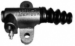

That looks very close to a Raybestos SC33723 Slave Cylinder. Not exact, but close....
http://ecx.images-amazon.com/images/...TL._SL500_.jpg
shark 09-06-2008 05:06 PM
AutoZone will have the part: "Brakeware part# 12413" for a 1988 Isuzu pickup
crosses with:
Bendix - 12247
Wagner - F124279
Raybestos - SC37833
