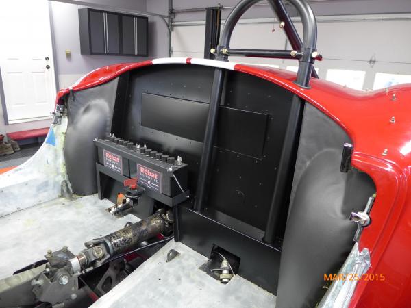

Here's my story of the most botched passenger side harness installation ever... This is how my car came from Barrett Jackson.
The passenger side harnesses were mounted to the rear seat rail screws. The right side harness attached under the left side rail and vice versa and were crossed behind the seat and held together to keep them from flopping around by something like an elastic hair band.
That coupled with the warning that shoulder harnesses without the roll bar convert YOUR HEAD AND SHOULDERS to the roll bar, meant they came out. A few months later my wife asked why she didn't have shoulder harnesses and after the explanation never rode in the car again.
