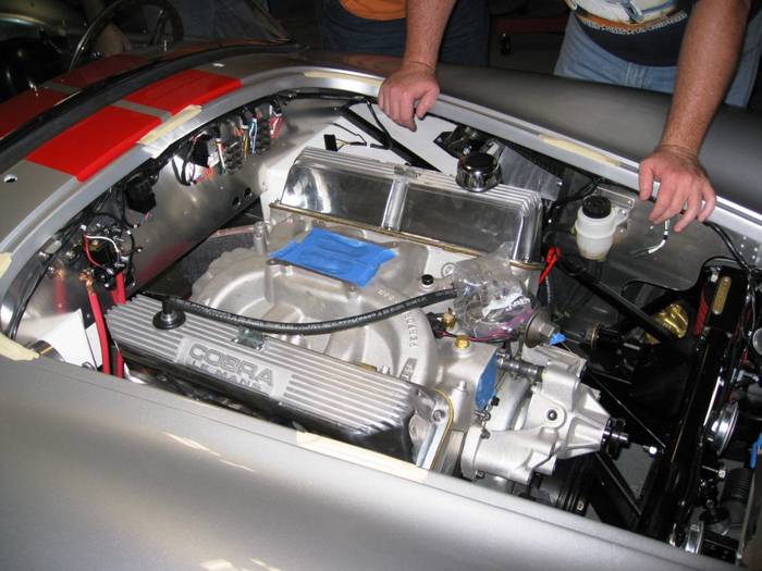

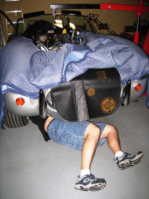

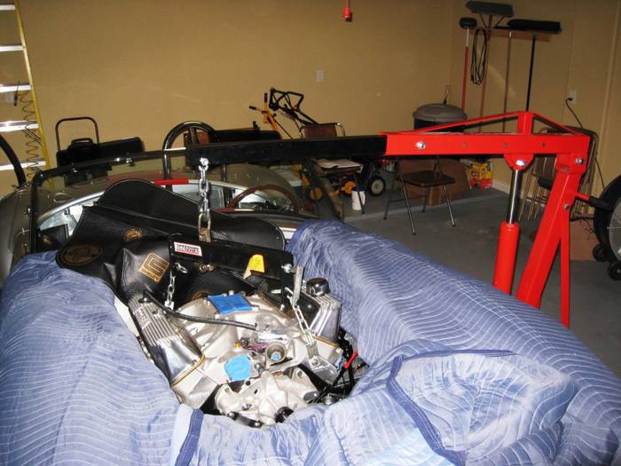

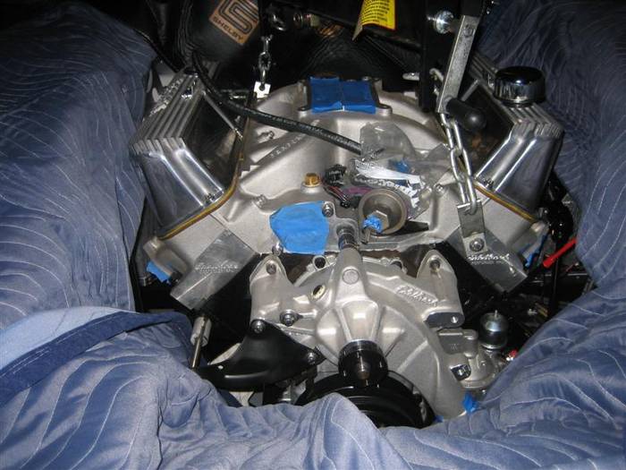

Relatively few issues .. surprise, an FE just barely fits in an ERA .. a car designed for it ;) We really needed JRoss' fancy 4000lb engine tilter. My hoist was too short to go over the nose, so we did it from the side, after removing one wheel .. something I learned from reading ChuckBrandt's build thread.
Here's the crew getting ready to go down ..
http://www.clubcobra.com/photopost/d...36_Medium_.jpg

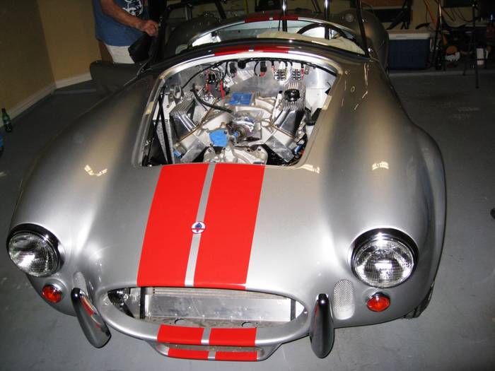

It's in there ..
http://www.clubcobra.com/photopost/d...45_Medium_.jpg

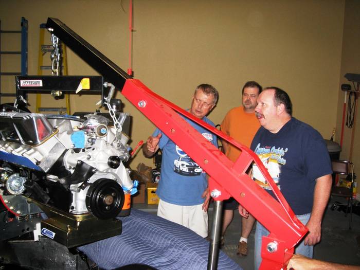

Stabbing in the DKT aluminum toploader ..
http://www.clubcobra.com/photopost/d...50_Medium_.jpg
Issues: can't get a torque wrench on the engine mount lugs, just got them as tight as we could with a box wrench. And the OEM style alternator bracket bolt actually touches the right shock mount .. must use the ERA provided hardware. Had to cut the OEM off with a recip saw .. we were NOT going to lift the engine to save a damn bolt:LOL:

glad it went in relatively smoothly. What did you do about the blanket stuck between the bolt and shock tower?? (from the other thread)

Is that a vacuum advance distributor? What's up with that?
I'm also quite jealous, an FE? Ya lucky turd. And a great looking vehicle ta boot. With that much help, I'm surprised ya got anything done.

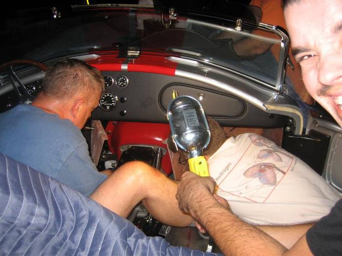

Sammy I'm sure you have another pic available ( you know one where i'm not so up close and personal in the side of the photo)

Steve! That is a vacuum advance .. it came with this gently used engine. Shortly I will replace it with an MSD billet, but right now it is keeping track of #1 TDC for me :) Of course you don't need FE p*nis envy, you have a 460 BBF, for goodness sake.

Patrick, I used that photo just because you were in it :D

The realization that it's not going to get there going over the nose.
http://www.clubcobra.com/photopost/d.../005-small.jpg
Aaahh. Mo betta!
http://www.clubcobra.com/photopost/d.../007-small.jpg
