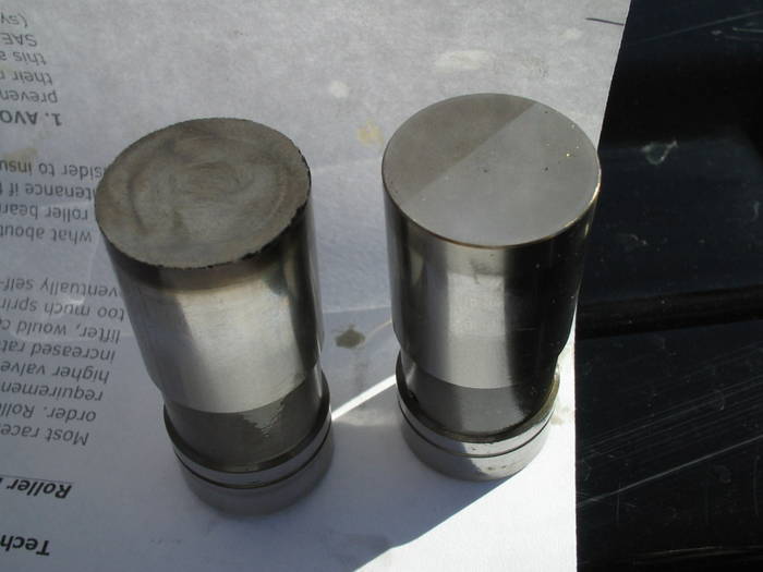

Since Jim complained of noise from the back drivers side bank, I started at the back cylinder and pulled the lifters out. First exhaust and intake pulled out easy. Second intake pulled out easy. Second exhaust would not come out more than 1/4" and then stuck. Uh oh. I put a small rag on the end of the lifter for grip, and to protect it, and pulled on it with a pair of channel locks. Out it comes, sporting a caved in bottom.
Yep, cam lobe failure in the making. Ticking noise explained. With no more than 2-3,000 miles on this car, there is no question that this cam never got past breaking in. Folks see this a lot nowadays. Good news is we caught it just before lots of metal slivers crunched off the lobe and the lifter.

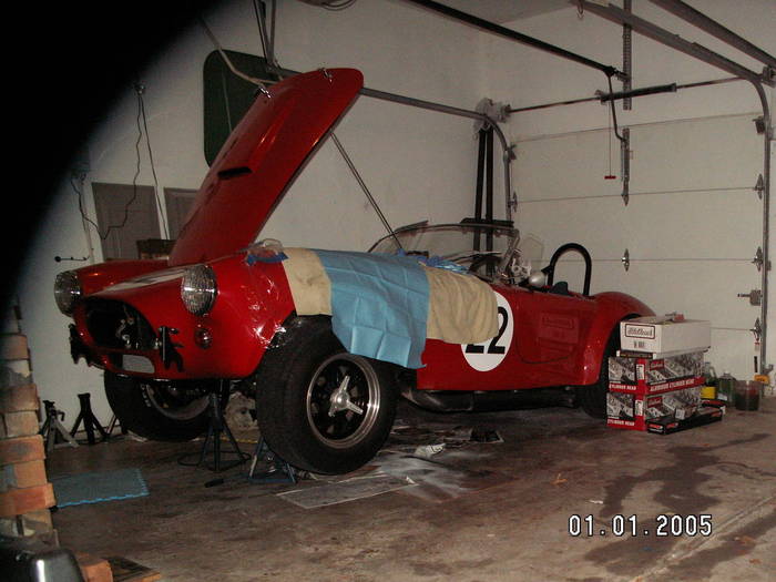

Here is the scene of the surgery:
And the engine upgrade in process:
Boxes of goodies:

Old 02-03-2008, 07:20 PM
LuvDaBlues's Avatar
Location: Heath, TX
Posts: 756
Hey John,
You're living in the past. Or you need to set the date stamp on your camera.
Looks and sounds like you two are off and running. I'm wondering if you'll be up and running before me now.

Old 02-03-2008, 07:27 PM
jdean's Avatar
Join Date: Jul 2001
Location: Carrollton, TX
Posts: 1,735
Yeah, my camera batteries were dead and it came up with that old date when I replaced 'em.

When good lifters go bad.....see the overheated darkness and the rough bottom on the bad vs good lifter? This already had worn the cam lobe down some, but we caught it in time to avoid a complete rebuild due to metal flakes.
