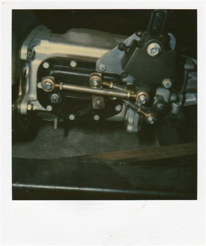

lal Naja 05-14-2010 09:22 PM
Would it help any if you had a shifter setup like this?
Arthur
http://www.clubcobra.com/forums/pict...pictureid=2526
