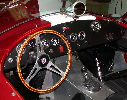

Here's mine....
http://www.clubcobra.com/photopost/d...0170Dash_3.JPG
Yeah, I know, that LOOKS like a 289 Cobra 4-speed shifter - well, I guess it SHOULD, because that's what it IS. I grafted a 289 Cobra 4-speed shift lever onto my C-4 shift lever. Even the reverse lock-out works. I put a slight "bend" to the left in it, so when the C4 is in "Park" the shifter appears to be in the position of "Reverse" for a Ford 4-speed.

btsai 06-04-2004 07:02 PM
Jeff,
That is a FANTASTIC job. Looks terriffic.

wire nut 06-05-2004 10:04 PM
Verry nice!! Jeff you must have put a lot of thought into getting it just right. Were you able to use back up light and neutrial safety connections? Necessity is the mother of invention.
