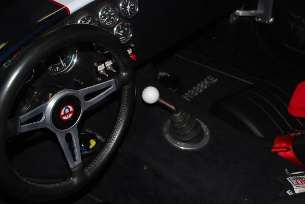

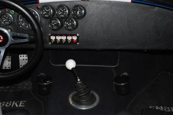

SF_SN888KE 08-21-2010 03:59 PM
not a T-5, but a follow up picture of my Jordon Short track shifter on TKO 600 mid shift kit location
http://www.clubcobra.com/forums/pict...pictureid=3990
notice offset towards the driver
http://www.clubcobra.com/forums/pict...pictureid=3989
