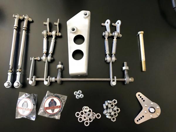

Contact John "CompClassics" in case you're interested on a correct Weber linkage.
I'm sure he can help.
My last order:
http://www.clubcobra.com/forums/pict...ictureid=17777

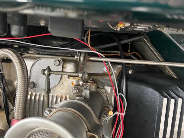

Here's how mine is setup:
http://www.clubcobra.com/forums/pict...ictureid=21386

This is the piece/arrangement I’m trying to figure out.

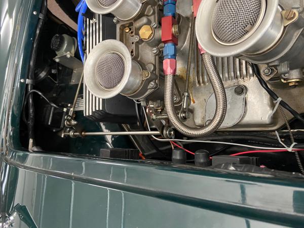

Hope that this helps. BTW, disregard the wires, I'm in the middle of installing a new ignition system -- they will be tidied up.
http://www.clubcobra.com/forums/pict...ictureid=21388
http://www.clubcobra.com/forums/pict...ictureid=21387
Pmccooey 10-30-2024 12:14 PM
Thanks!! Similar to mine but your lever goes front to back and mine goes side to side. I assume I would need a bell crack attachment to transverse it.
