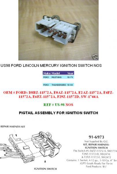

    http://www.clubcobra.com/forums/pict...pictureid=1181
    See if this is your ignition switch
