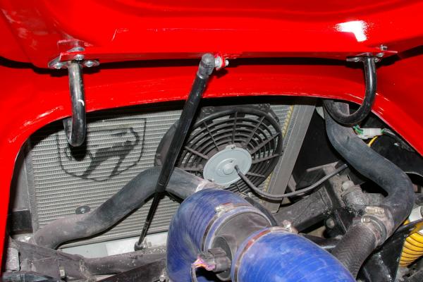

Simple and it works! Hard to see here but its a piece of aluminium angle between the rear bolts on the hinge the strut pushes and holds no worries, don't know where I got the strut from but it looks like a pulsar one I had lying around. Length was just right. Go to the wreckers when you work out what length, and there is a smorgasbord to choose from.
