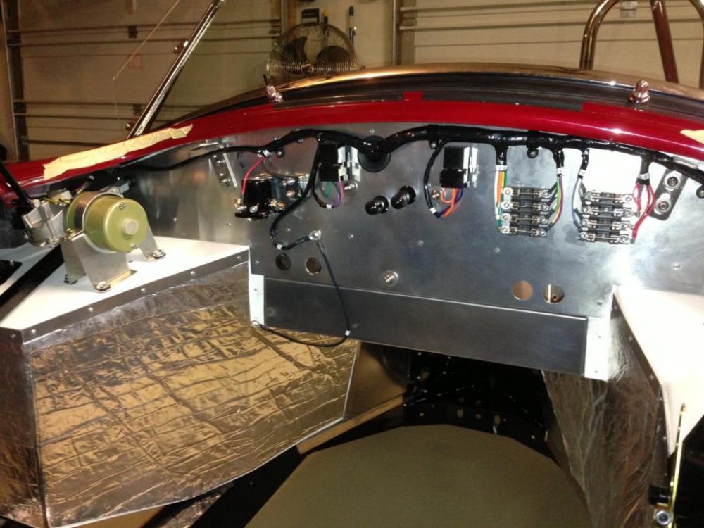

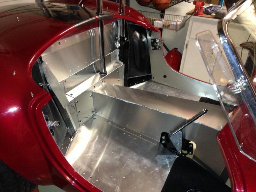

Have been working on the car with my son...mostly on wiring and suspension. My wife and daughter peeled the protective film off the aluminum and promised to come back to do the trunk.
The dash and firewall are wired and the wiper motor and mechanism are in. Love that old timey looking Lucas wiper motor.
Added a stainless steel accessory outlet and the heated seat controls hidden under the dash in the flange (Go ahead and flame me for the heated seats. I enjoy cold weather riding on my Harley and love the heated grips... I'm sure we'll enjoy the heated seats in the Sping and Fall).
Suspension is mostly in. I don't have the jam nuts for the tie rods, so will install them when I receive the nuts from ERA.

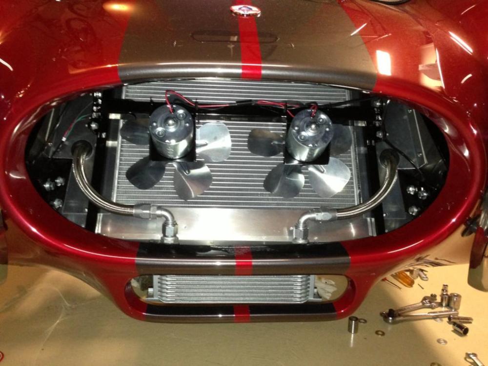

Oil cooler is mounted.
Mounted the MSD box and noise filter capacitor on the bottom of the glovebox frame.
