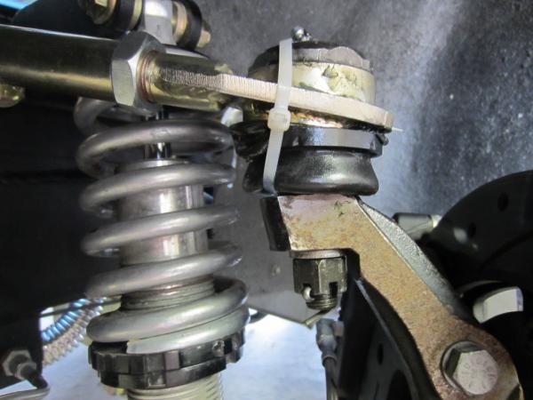

Your ball joint cup has a 10 degree offset but right now you have it offsettig the wrong way. So need to unbolt the cup on each end and flip it.
Doug
