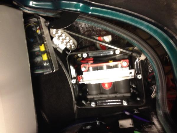

Originally Posted by Xack View Post
Take a look at the lid mounted bracket. The shape allows the strut to apply no upward pressure to the fiberglass lid.
Neat installation - just remember gas struts should always be installed with the main body on the top side and not like you installed them - unless those are special struts??
See here:
Gas Spring Mounting Instructions | Industrial Gas Springs
