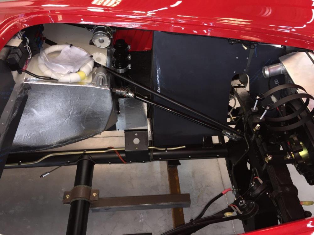

Attached are some new photos showing the front transverse leaf spring suspension. Real nice looking work.
Jim
Jim
I sent Ross a note regarding the suspension....before you do anything....you must square up the suspension to the chassis....
Then it needs to be bump steered.....both front and rear....that has been a real issue with these cars since I got involved with them......it will make a huge difference on a race track.....driving on the street verses a track is way different....and the loads You put on the suspension will cause it to do strange things......they can drive ok on the street.....but the track will show a different side to the suspension.......
Just a thought....
Morris
