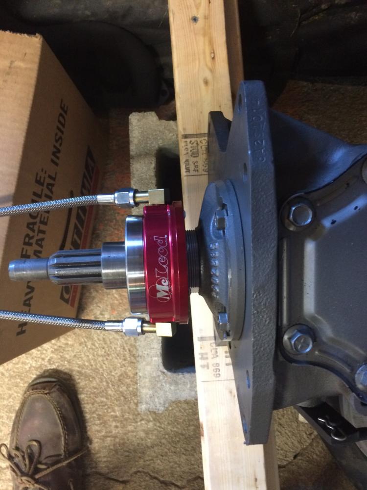

So, have kept up the pace a little, although was slowed down slightly for a couple of days. Realized that the slave cylinder and fork setup was not going to work due to space considerations, so had to order a hydraulic throwout bearing. When it arrived I was test fitting it on the Toploader, and these things are a tight fit. Well, the transmission was sitting on top of a couple of 2x4's on top of concrete blocks and as I was trying to slide the throwout bearing onto the shaft the transmission slipped and fell on my left-hand middle finger. Split it open like a hot dog/sausage on a grill. Let loose a few choice words and then finished placing the bearing on the shaft. It was after that that I realized i was bleeding quite well and that a bandied would not be sufficient, so it was off to urgent care for a little surgical glue. The NP did mention what big hands I have! Seriously though, I really do have big hands for my size, I can palm a basketball with either hand ad am only 5'10".
