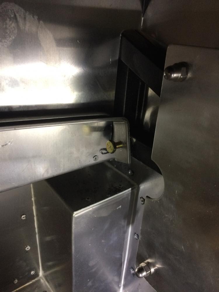

I then move to the trunk and worked on the mounting of the fuel cell and fabricated a steel bracket to hold the fuel cell in place. Had to drill and tap holes in the bracket and the frame to secure the bracket.
